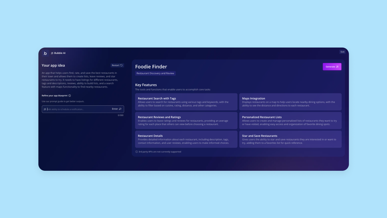

Building an app with the Bubble AI Agent
On Bubble, generating your app and editing it are one continuous conversation with the Agent. You describe your app, and the Agent turns it into a plan you can review before it builds anything.
Generating the app, including the planning session, doesn’t use AI credits. From there, you can keep building with the Agent or switch to the visual editor to make changes yourself.
  1. Share your idea: Describe your idea to the Agent in a few sentences, including the key features you want. The better your prompt, the better your output, and this guide to great prompts has tips.
  2. Shape the plan: The Agent starts a planning session. It asks a few clarifying questions, then lays out a plan with the features and user scenarios your app will include. Add or adjust anything that doesn’t match what you have in mind, then click Generate.
  3. Review your first draft: When it’s done, you have pages, a database with sample data, and workflows (the step-by-step logic behind each action in your app). The features should already work, and you can start testing and building on them right away.
Click through the editor tabs to see each page, workflow, and data type the Agent created. Everything is laid out visually, and you can see how your app works before you change a thing.
